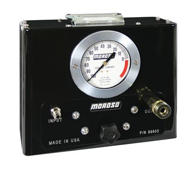

                        I was checking out that leakdown tester, but it had received really crappy reviews. I'll borrow one from a friend.

                            I was checking out that leakdown tester, but it had received really crappy reviews....../Magnus F.
                            I noticed that but I suspect these folks just did know know what to do with it or how it works. I have it and while not a masterpiece of aerospace engineering it works just fine. It is only a pressure regulator, 2 gages, and a small orifice.
                            I am sure there are better ones but they do the same thing.
