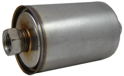

    Looking to replace the fuel filter. Found out it is off of a Rover Metro, and can be found as P/N HFF217 at Halford's, but that isn't much help. Anybody know of a reasonable source for a suitable replacement unit, please?

      Here's what I have...you should probably double check on your own.
      Cross References for this filter:
      ADL ADG02302

          Thanks, Randall. I didn't even think to search for "filter cross reference" or similar. :( It would seem both A and D are the correct answer! :)

            It's available from Summit Racing and Rock Auto.
            Search on the Fram number.
            I haven't checked Pep Boys yet.
            Randall, thanks for the cross references.
            Free Shipping - Fram Fuel Filters with qualifying orders of $99. Shop Fuel Filters at Summit Racing.
            The Purolator number shows up on Amazon.com too.
            Does it idle OK?
              Idle has become erratic sometimes, but not always. Easy enough to replace the fuel filter and see what happens.
              Also found: WIX 33481
              Using the Fram and Chevrolet numbers found a number of suitable replacements from many sources where I can get a part same-day, including O'Reilly, NAPA, etc. (and probably Pep Boys too). Thanks again, Randall.
