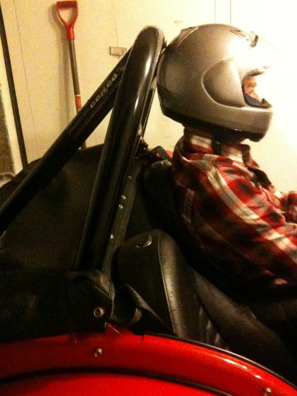

                I am still having an issue with this. Now with photos and more explanation. Not sure if I am ready to go through the hassle (and expense) of the lowered floors yet. My post from USA7's.
                So, I ordered an FIA bar for the Caterham this past summer and it took some time to get here (October). I was a little concerned with the forward lean of the bar, but that was more from a cosmetic standpoint than anything else. Then I installed it. And the uh, oh's ensued.
                As you can see, not exactly a lot of clearance between my soft head bits, and the very hard FIA bar bits. I am lacking the headrests on my stock Caterham seats, and originally I thought they might do the trick to protect me from the bar but was skeptical. Then I had my wife take these photos of me sitting in the car. The one that really made think this was not going to work was this one.
                Basically zero clearance with the helmet on. I could maybe fit a 1/4" pad between the helmet on the bar. After sending these to Ben at Caterham USA he still seems to think that I should be able to use the headrests to protect me from the bar, but I don't see how, even with the 1/2 versions (https://www.caterhamparts.co.uk/prod...b1b3f11ca49579) that this will work.
                Thoughts from any other FIA bar owners? I am 6'2" which makes this more of a challenge.

                  I'd go with lower seats before doing floor lowering. I just installed a pair of race seats, which should be a bit lower:
                  Foam seats would do it too.
                  /Magnus F.
                    I believe the general recommendation* is to have the top of your helmet 2" below the top of the roll bar. I'm going to take a wild guess and say that even with a thin seat you're not really going to have 2". You can easily test this by removing the seat bottom and taking another picture. Note: a foam seat will sink you in the car even more since you can vary the angle - just don't make the mistake I made and lay down too much! My current foam seat has me looking directly down the bonnet! This puts strain on my back and I can't see as well as I would like. I'm going to try making a seat again, but with a slightly more upright position.
                    Regarding your head and the roll bar - I find that the stock leather seat headrest works fine. It does prevent the seat from sliding all the way back - and the back of the headrest gets compressed by the cross bar, but it will protect you and your helmet (note, I've not had a chance to test this!). I recently purchased some SFI roll bar padding and will fit that for trackdays. It is very hard, but in an accident really dissipates the energy so your noggin does not contact the metal of the roll bar. Link here: http://www.racerpartswholesale.com/p...ollbar_Padding
                    *A better recommendation is that you have 2" from the line formed by the top of the roll bar and the top of the chassis rail at the front of the car.

                      Turns out that I have a somewhat limited clearance between my helmet and the top halo hoop of my roll cage. I used to have foam padding, which would remove any clearance, so I'll definitely go with the padding you listed.
